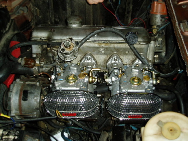

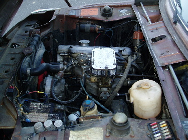

Post by ridr4lif »
The first pic is of the old set up, obviously, and the second pic is the new set up not completed. Once my g/f comes to visit me i will take a pic of the finished product w/ the strut bar in place. Let me know what ya think! :sm29:

Post by Jonathan »
Looks sweet, I always liked Webers. With 9.5:1 compression and a hotter cam you shouldn't need premium gas, unless you milled down the heads or went to a thin head gasket and the 9.5:1 is rated for a stock cyl. head. Dynamic compression lowers with a higher duration camshaft.
