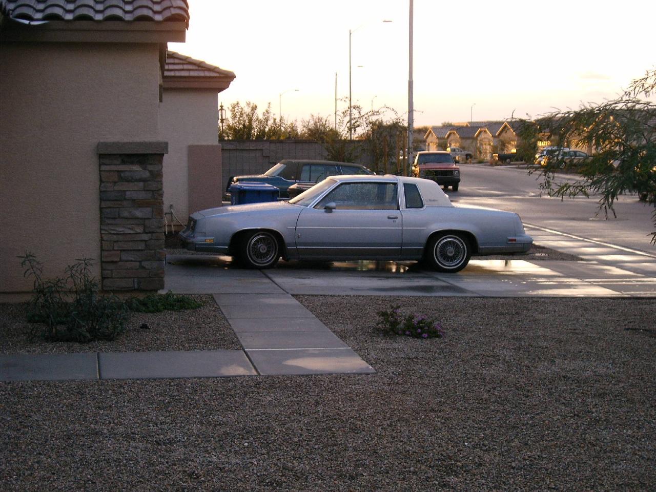

Awesome thanks for the reply's i will look into those amps . If you guy's got any other tips please let me know . Like i said i purchased a high output alternator 150 amp and im putting a secondary battery i believe its an optimum dont know the size my bro left it behind for this setup. Do you guys think i will have a power issue . I will be using another amp for voice . Im not a professional audio tech as you can tell i have put my own little systems before and haven't had an issue .I want to put a little more effort and detail on this one for my bro . What other components do you guys recommend for like noise cancellation , capacitor's , fuse size's , etc and any other components that will make this a better setup ? Please keep in mind im not out to spend a grip load of money just wanna get as many little items that make a difference in sound quality and dependability . Here is the car its going in . I sold it to my bro for $1,200 i think he got hooked up. One more thing i have an old Harman Kardon TC600 amp (nice power) which i used to have it hooked up to 3 JL 12w6 8 yrs ago and i removed because it kept going off on protection . Any clue as to what it might be and would it cost alot to repair.Thanks for the help guys..Em
