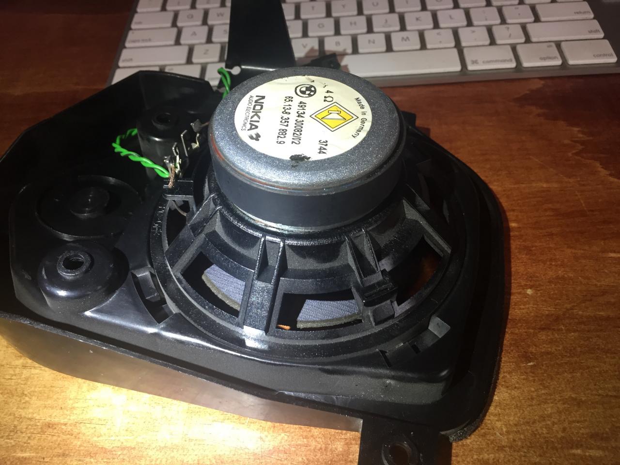

I took some pictures of the mount, which is the difficult part. But first, some new observations:
- single feed line for full range
- 4" speaker (100 mm)
- 56 mm depth of OEM unit
The mount is the issue here. It's not standard. Can I just drill this and use flange foam tape to seal it?
Can anybody suggest some options?
Cheers

[ATTACH=CONFIG]2150[/ATTACH]
[ATTACH=CONFIG]2151[/ATTACH]
[ATTACH=CONFIG]2152[/ATTACH]
Are you trying to mount your new speakers into that plastic holder?
You have a couple options, you can try and modify that bezel and adapt it to fit your new speakers.
Or you can try and create your own mounting bracket mount your speaker to that, and then mount the assy to the car in teh factory spot.

Yes, there is no option. That mount/enclosure I have to use. Making a mount is something I don't want to do. I don't have the time, the tools, nor the patience. I can modify the current mount, which is perfectly good, but I have to find a way of tapping into it. I just don't know the tools or methods used by those in the know. But other forums are sending some ideas.

Just watched the video, looks like he put some type of ring inside the opening so his upgraded speaker doesn't fall through.
Is that correct? I wonder if something like that could be 3d printed?

I think so. Some kind of rubber gasket that's white. I bought some black stuff today. 3D printing is something I am somewhat chasing, but I've ordered speakers that seem to fit. I'll re-assess when the speakers get here.
