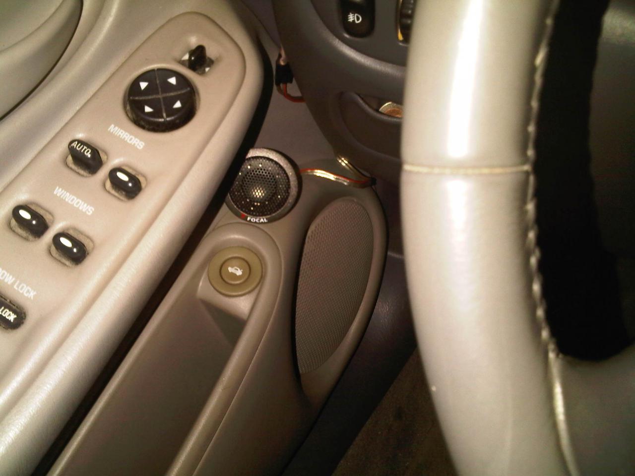

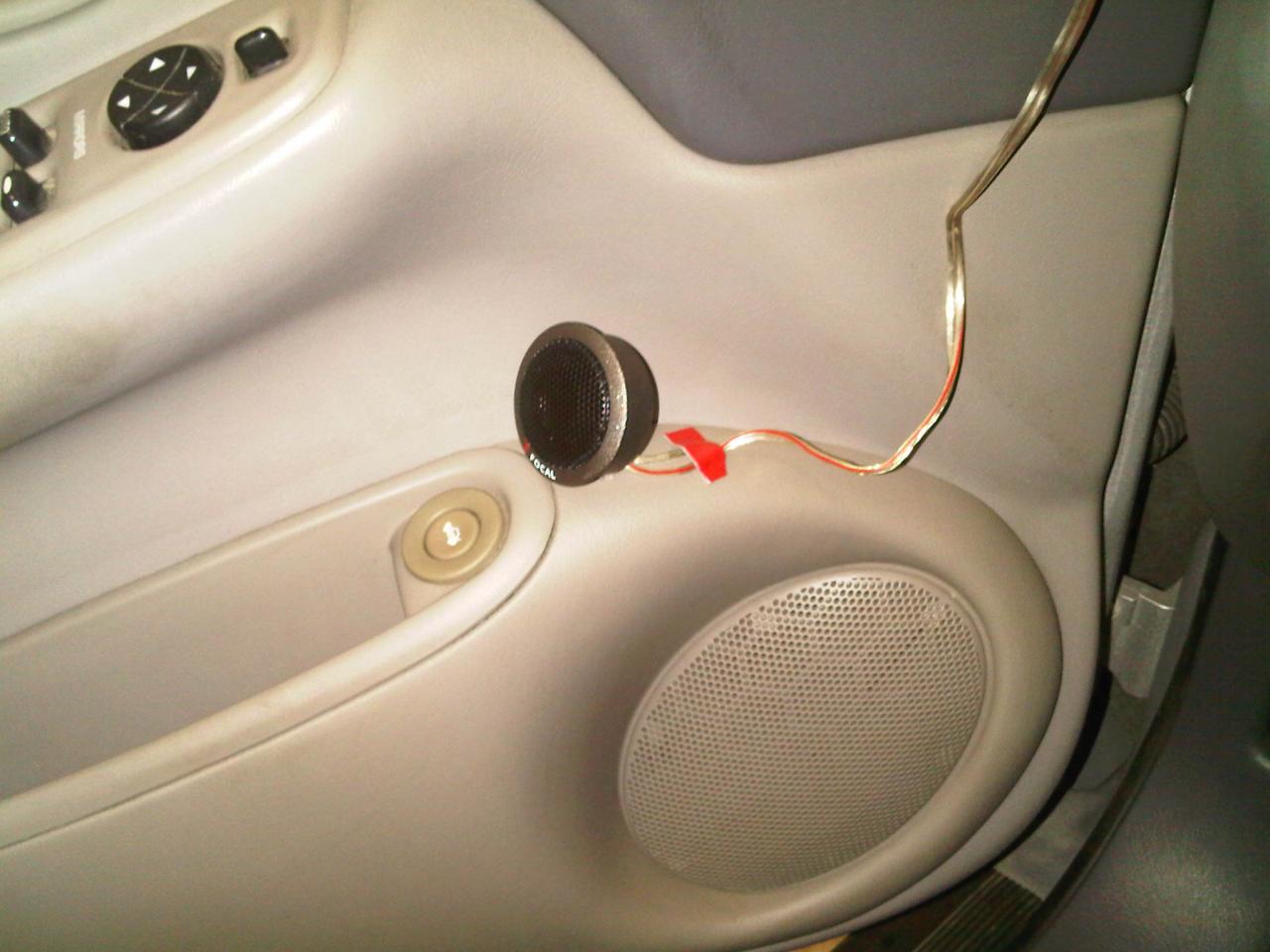

here is one idea i came up with, the sound is alot cleaner just by moving that one tweeter down there. thoughts?

oh god TN 52s
Get those things down in the kicks. Trust me. The reason they sound better they are bad with reflections, especially off of glass. The way you moved them took away the reflection off of the glass and cleaned them up.
Sometimes they do good firing directly across the window but you loose out on depth, and they can get pretty peaky.
They tend to sound real good off axis on the kicks but again you will loose out on depth.

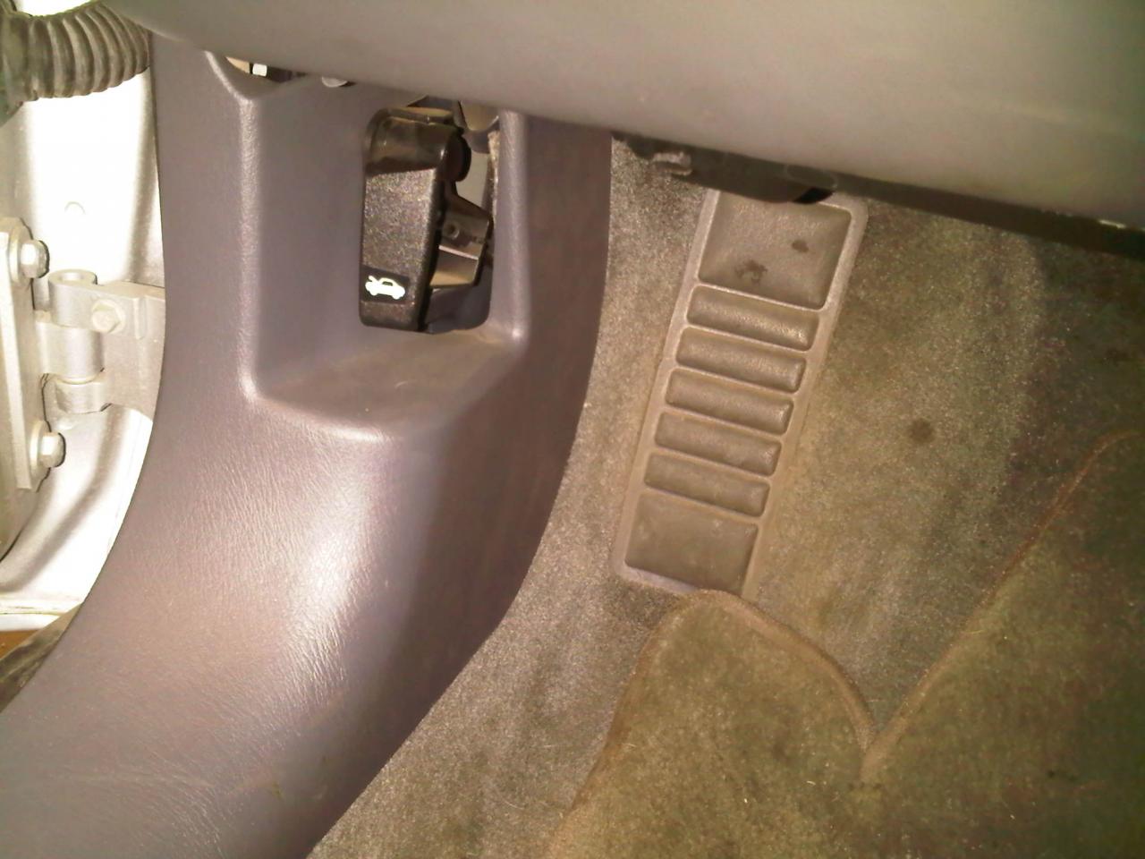

i dont have the room in my drivers side kick, the hood pop lever is in the way.

sure you do. small trim ring, little bit of grill cloth and some fiberglass and your golden.
