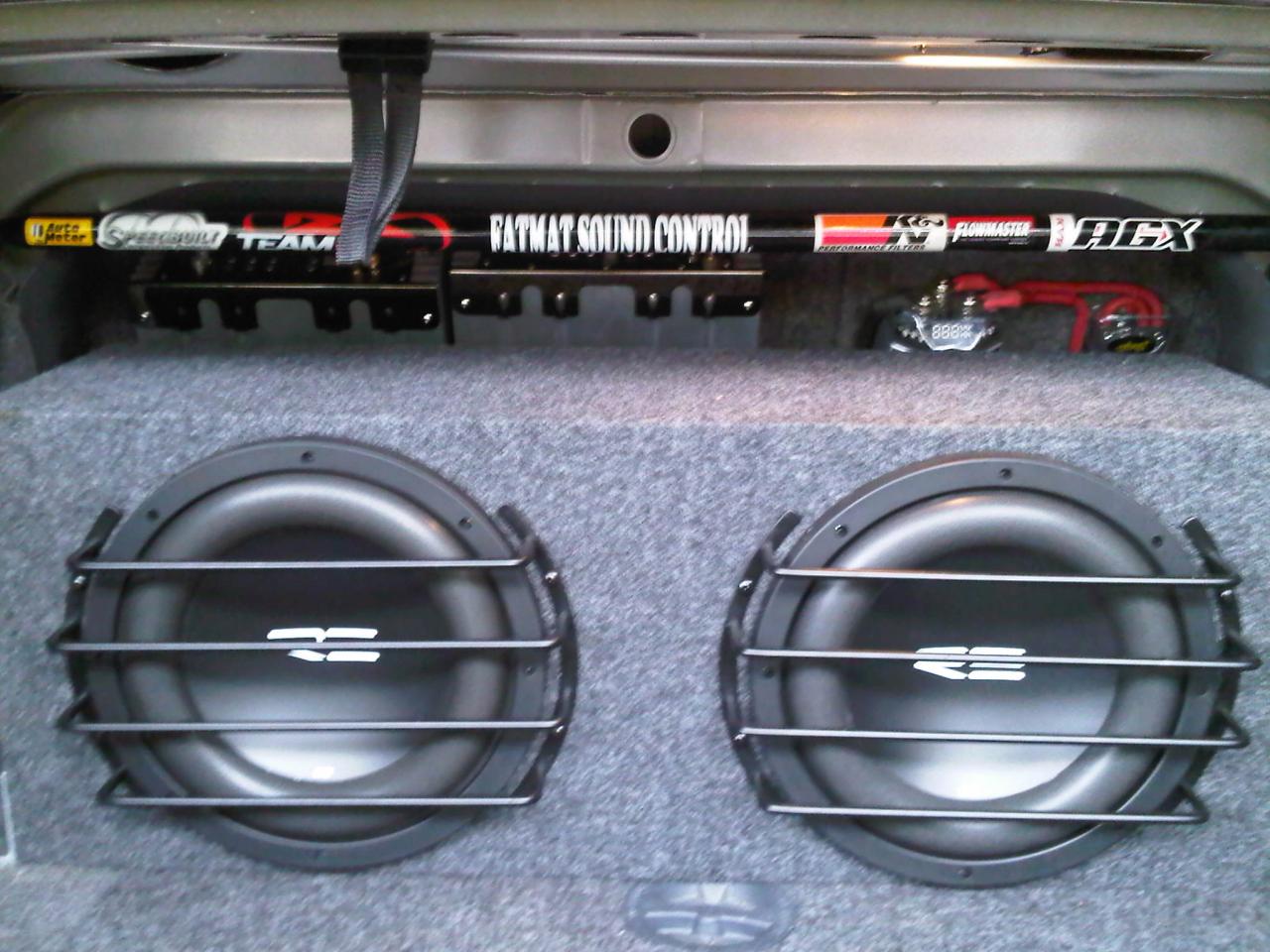

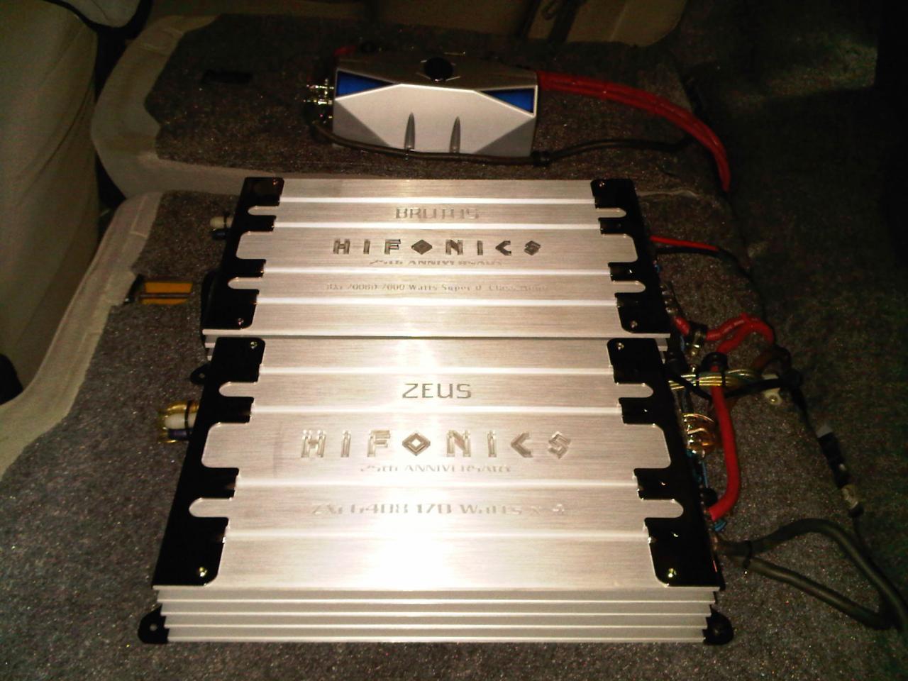

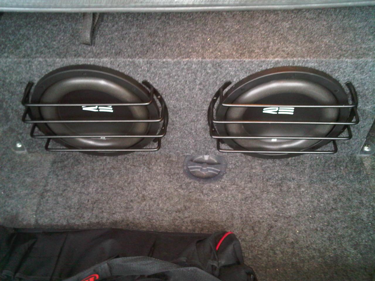

here are pics of my setup, my headunit is set flat, i have done done any tuning with the headunit yet.
my issue with doing a ported box, is that i am not a box builder, unless i can find a prefab in the proper specs.
James-aka-Cool Mr Grinch

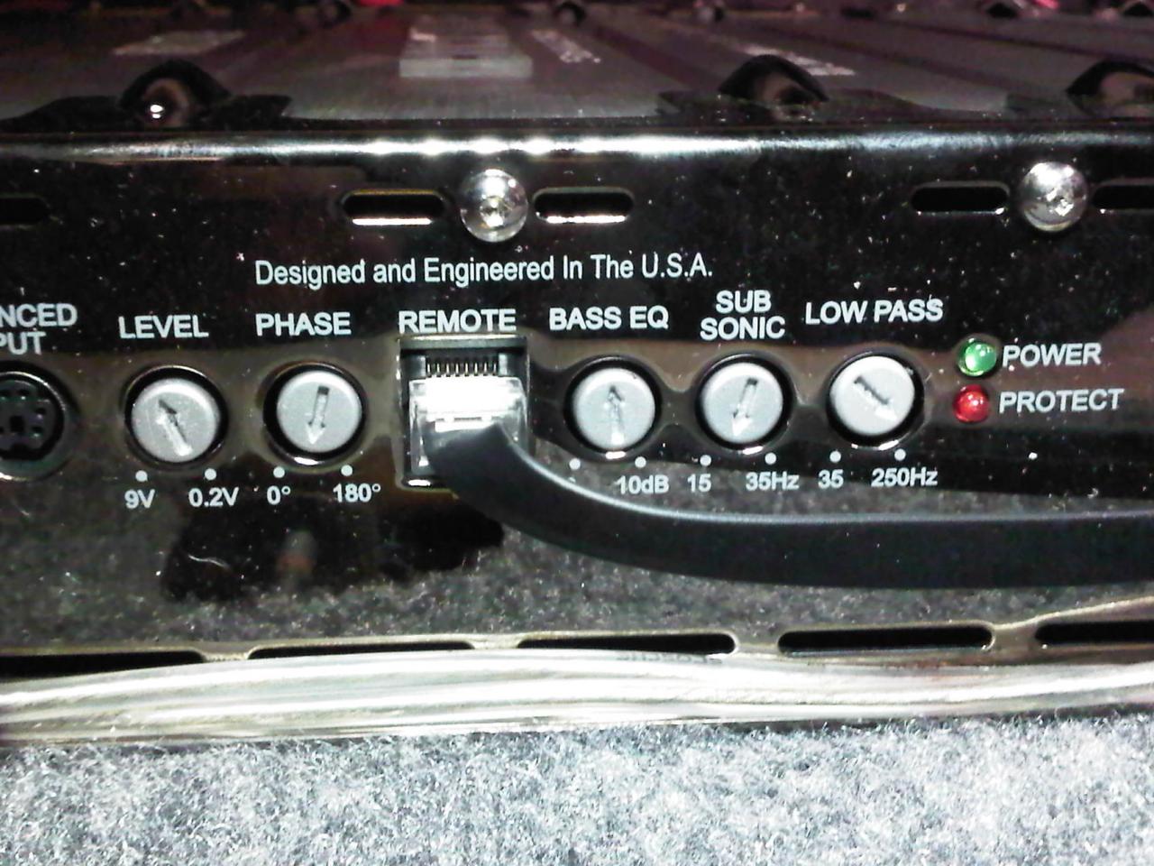

turn the bass boost all the way down, adjust the gain with a dmm as described in amplifier section, turn the lpf to about 80-100 hz, cut all bass boost from h/u.

it is adjusted with DMM, i have a bass control knob under my headunit that is turned all the way down, ill change the lpf setting.

Yeah, 80hz should do nicely.
dave.
loudwagon15s wrote:turn the bass boost all the way down, adjust the gain with a dmm as described in amplifier section, turn the lpf to about 80-100 hz, cut all bass boost from h/u.
Agreed.
How did you set the amp with a dmm? Did you turn the bass boost up or down after adjustment? If your not getting the output and punch you want Its because you have small sealed boxes.
build a box....or have one built. good amps. good subs...tiny sealed box bad
