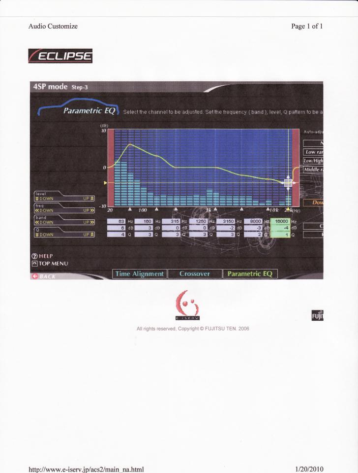

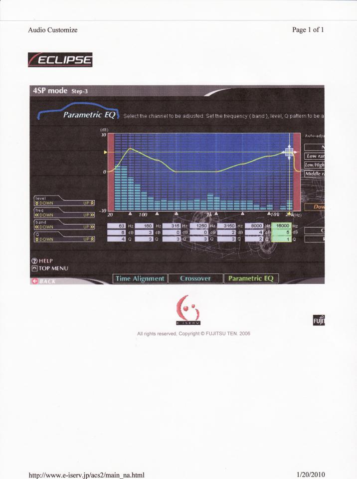

here are 2 more i setup last night, i have not saved or programmed my head unit with any yet, i am just trying to get an understanding of the freq settings, am i getting closer what your describing in either picture? or am i still ignorant and way off?
this also explains some of my bass issues as discussed in another topic.

Yeah dude your bass is still to loud to get a good FR reading.
Cut your bass by about 6db on the time delay page, and then do another sweep.
Roll off means cut.
So when I say roll off by 2 db an octave, I'm talking about making each octave above a certain freq quieter than the octave before it.
So if 5K is at + 4 on the chart then 10K you would want at +2 and 20K you would want at 0.
But do do that you really need to get the lvl on the base down, do the sweep, and then bring the base back in once you get the mids and highs adjusted.
Refresh my memory on your set up, and how everything is wired coming out of the head unit.
Roll off means cut.
